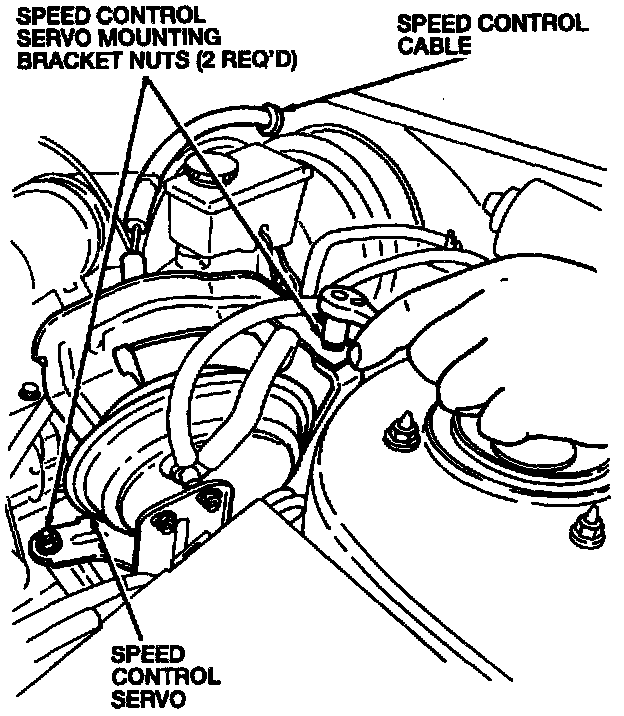

REMOVAL1. Disconnect the battery ground cable.
2. Remove the two speed control servo mounting bracket nuts.
3. Disconnect the speed control servo electrical connector.
4. Remove the three vacuum hoses.
NOTE: Label the vacuum hoses and the vacuum ports to ensure proper installation.
5. Remove the speed control cable adjusting clip from the speed control cable.
6. Remove the two speed control servo nuts and the bracket from the cable side of the speed control servo.
7. Slide the speed control cable end housing away from the speed control servo.
8. Disconnect the speed control cable and remove the speed control servo.
