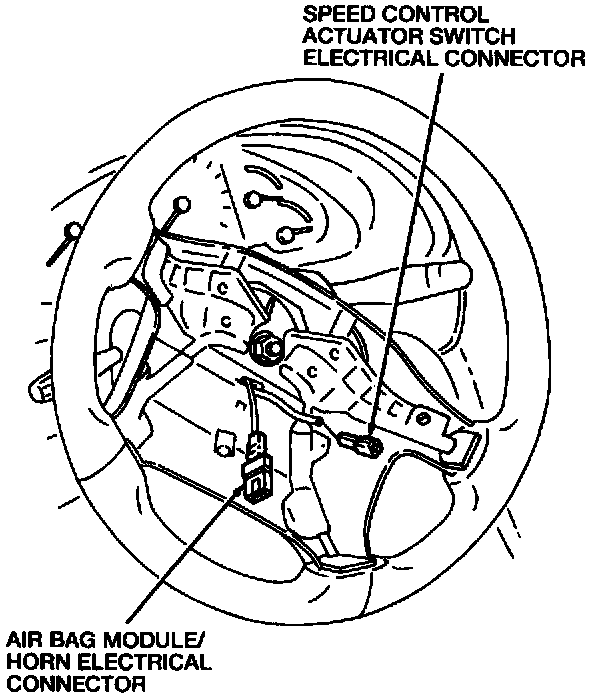

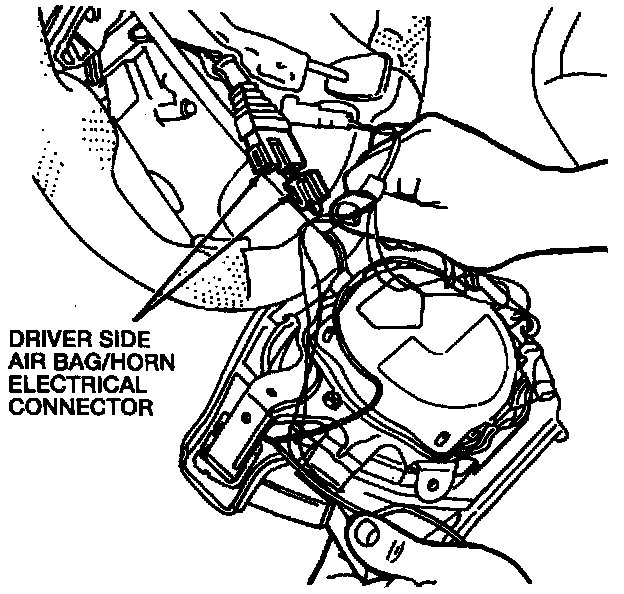

2. Remove the four driver side air bag module bolts from the back of the steering wheel.
3. Disconnect the driver side air bag/horn electrical connector from the driver side air bag module.
4. Disconnect the speed control electrical connector.
5. Remove the driver side air bag module from the steering wheel.
6. Remove the four speed control actuator switch screws.
7. Remove the speed control actuator switches.
