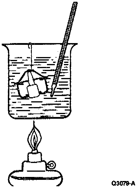

1. Suspend the water thermostat and an accurate thermometer in a suitable container. Do not allow the test pieces to touch the bottom.
2. Fill the container with water to completely cover the water thermostat.
3. Heat the water until boiling, and observe the thermometer temperature.
4. The water thermostat should initially open at 80-84° C (176-183° F), and be fully open at 95° C (203° F).

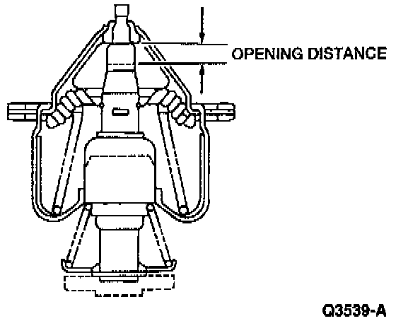

NOTE: Fully open means the water thermostat lifts a distance of 8.5 mm (0.33 inch) or more.
