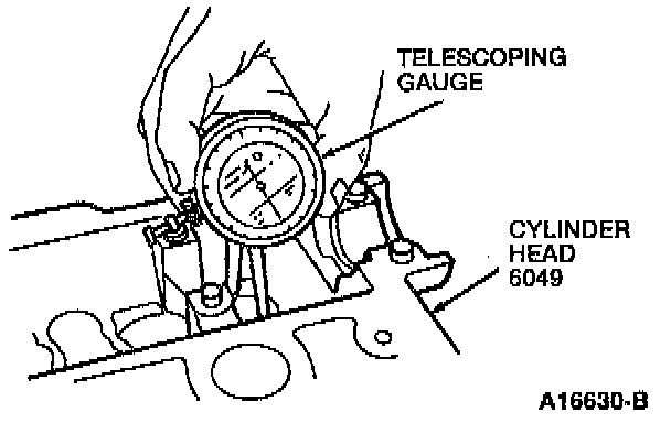

3. Measure the diameter of each HLA bore. The diameter of the HLA bore should be within 30.000-30.025 mm (1.1811-1.1821 inches).

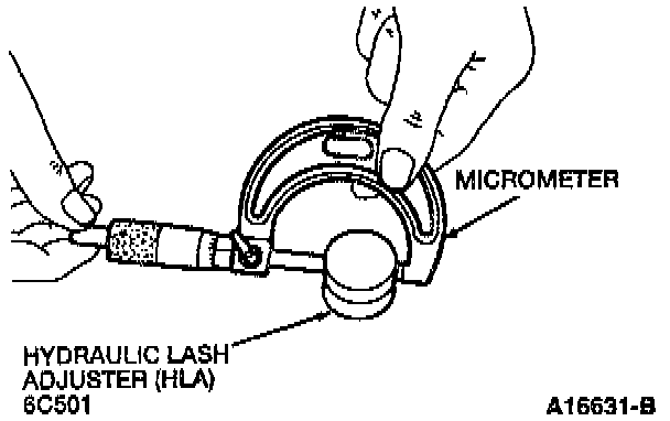

4. Measure the diameter of each HLA. The diameter of the HLA should be within 29.959-29.975 mm (1.1795-1.1801 inches).
