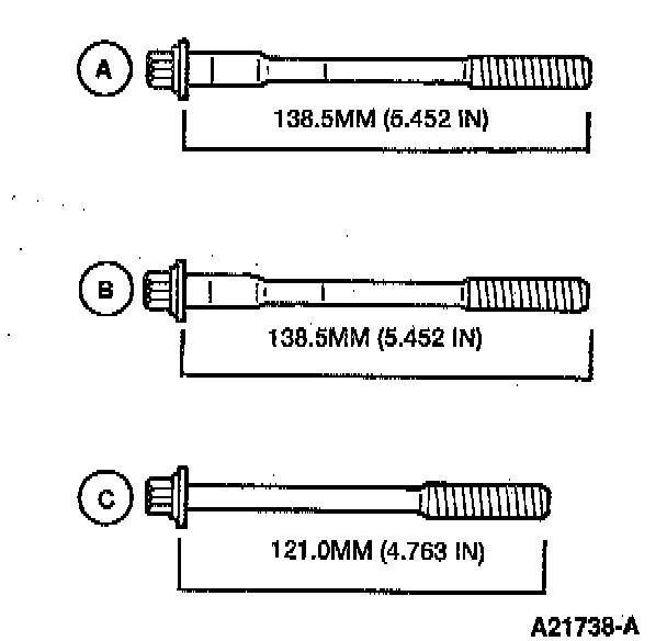

1. Measure the length of each lower cylinder block bolt before reinstalling. If the bolt length is longer than the following specifications, then replace it:
^ Cylinder block bolt A: 138.5 mm (5.452 in)
^ Cylinder block bolt B: 138.5 mm (5.452 in)
^ Cylinder block bolt C: 121.O mm (4.763 in)
Apply clean engine oil to the threads of the lower cylinder block bolts.
NOTE: The narrow part of the shank on lower cylinder block bolt B is smaller than lower cylinder block bolt A. Lower cylinder block bolts A are marked with a 4 on the head. Lower cylinder block bolts B are marked with a 1 on the head. Lower cylinder block bolts C are not marked.

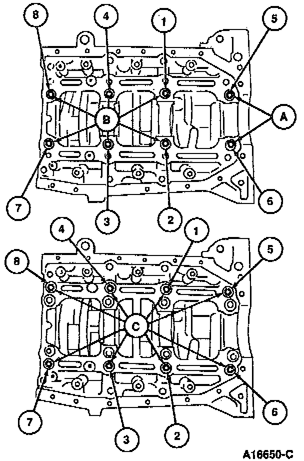

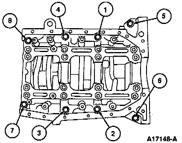

1. Tighten lower cylinder block bolts A and B in two or three steps in the order shown to 23-25 Nm (17-19 ft. lbs.). Tighten lower cylinder block bolts C in two or three steps in the order shown to 18-21 Nm (13-15 ft. lbs.).

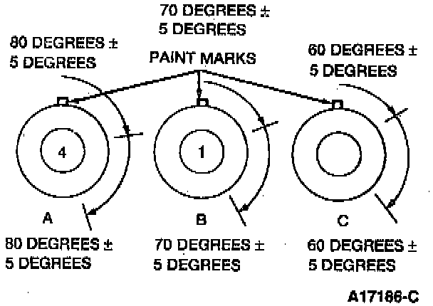

2. Paint a mark on each crankshaft main bearing cap bolt head.
3. Using the marks as a reference, tighten lower cylinder block bolts A by turning them 80 ± 5 degrees.
4. Using the marks as a reference, tighten lower cylinder block bolts B by turning them 70 ± 5 degrees.
5. Using the marks as a reference, tighten lower cylinder block bolts C by turning them 60 ± 5 degrees.
6. Further tighten each lower cylinder block bolt, an additional time, by repeating steps 3-5.
7. Tighten the lower cylinder block bolts in the order shown to 19-21 Nm (14-15 ft. lbs.).
