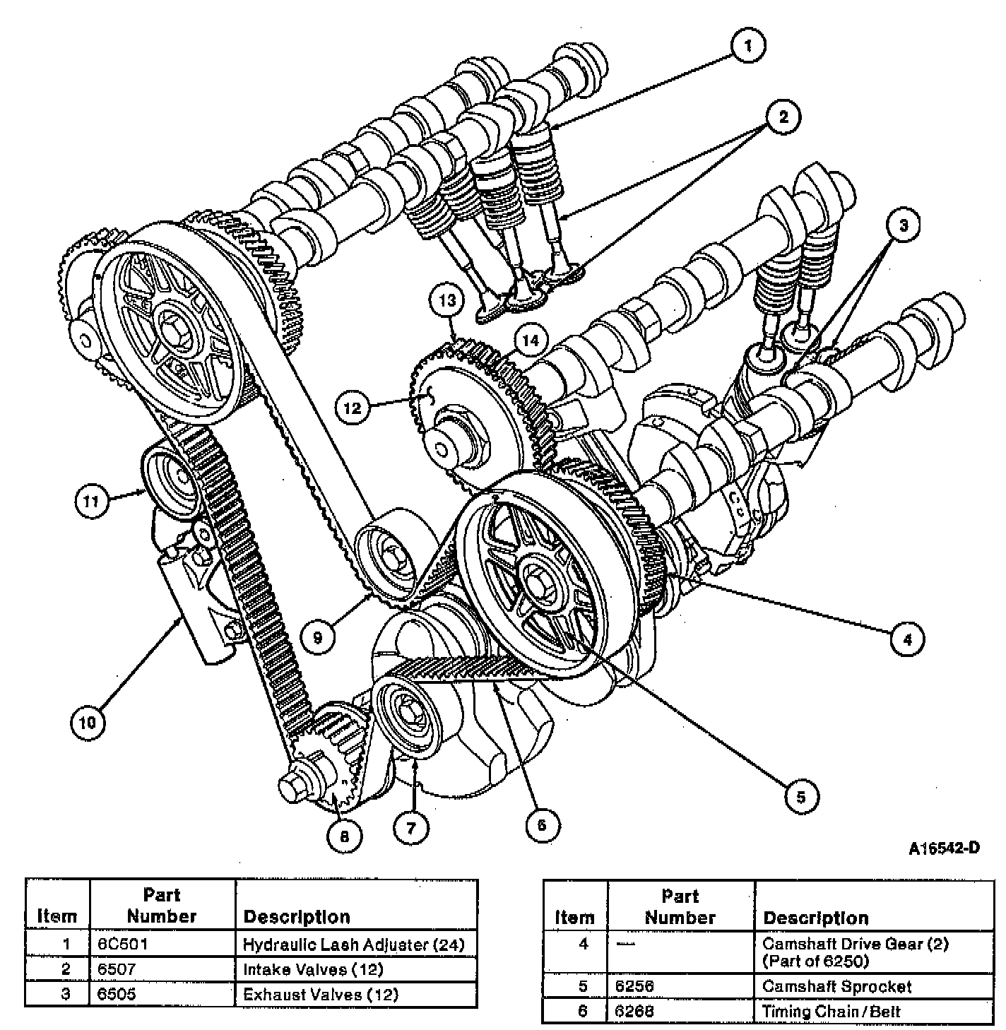

Crankshaft: Description and Operation
(Part 1 Of 2):
(Part 2 Of 2):
The crankshaft is supported in the lower half of the two-piece cylinder block by four-bolt main journals. One crankshaft sprocket and two camshaft sprockets combined with four camshaft gears, two timing belt idlers, one timing belt tensioner and a timing belt connect the crankshaft and camshafts.
