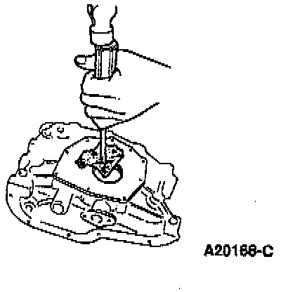

3. Use a screwdriver protected with a rag to remove the crankshaft front seal from the oil pump housing. Discard the seal.
NOTE: Protect the oil pump housing with a rag while removing the crankshaft front seal.

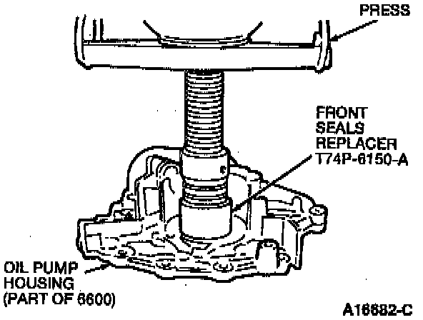

1. Use a press and Front Seals Replacer T74P-6150-A to install a new crankshaft front seal.
