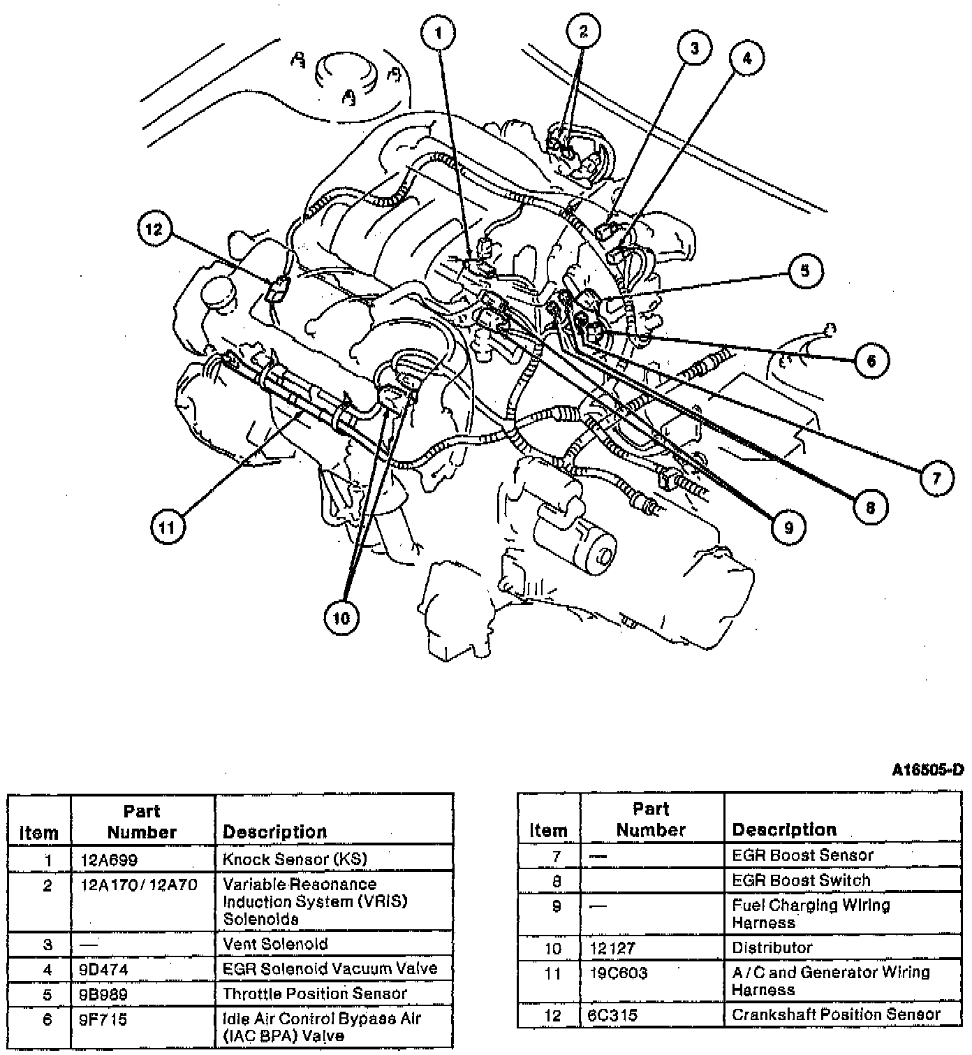

36. Disconnect the generator electrical connectors.
NOTE: Label all of the electrical connectors for ease of installation.
37. Remove the two A/C and generator wiring harness bolts, then disconnect the A/C and generator wiring harness from the front of the cylinder head.
38. Disconnect the two electrical connectors from the top of the distributor.
39. Disconnect the fuel injection supply manifold electrical connectors.
40. If equipped, disconnect the vacuum line from the speed control servo.
41. Disconnect the vehicle speed sensor (VSS) electrical connector.
42. Disconnect the starter terminals.
43. Disconnect the throttle position (TP) sensor electrical connector.
44. Disconnect the engine coolant temperature (ECT) sensor electrical connector and the water temperature indicator sender unit electrical connector from the front water hose connection.
45. Disconnect the knock sensor (KS) electrical connector.
46. Disconnect the crankshaft position sensor electrical connector.
47. Disconnect the EGR valve (EGR valve) and EGR solenoid vacuum valve electrical connectors and vacuum hoses.
48. Disconnect the park/neutral position (PNP) switch.
49. Remove the ground wire bracket-to-rear transaxle support insulator harness bracket bolt located near the starter.
50. Disconnect the idle air control bypass air (IAC BPA) valve electrical connector located below the throttle body.
