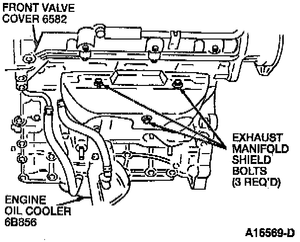

5. Remove the three exhaust manifold shield bolts and remove the exhaust manifold shield.

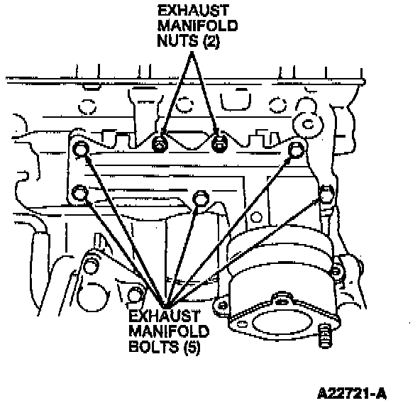

7. Remove the two warm-up three way catalytic converter shield bolts and the warm-up three way catalytic converter shields.
8. Remove two exhaust manifold nuts and five bolts from the exhaust manifold and remove the exhaust manifold and the exhaust manifold gasket from the vehicle.

^ Use a new exhaust manifold gasket.
^ Tighten the exhaust manifold nuts and exhaust manifold bolts to 19-25 Nm (14-18 ft. lbs.).
^ Tighten the exhaust manifold shield bolts to 8-10 Nm (7 1-88 inch lbs.).
