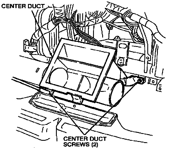

Center Duct
REMOVAL

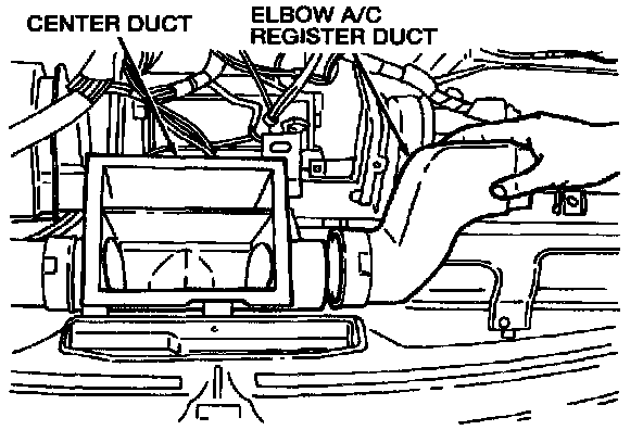

1. Remove the instrument panel.
2. Remove the elbow A/C register duct screw. Remove the elbow A/C register duct from the center duct.
3. Remove the two center duct screws.
4. Remove the center duct from the instrument panel.
