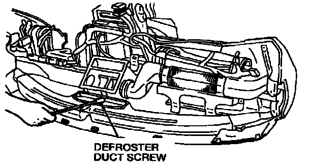

Defroster Duct
REMOVAL
1. Remove the instrument panel.
2. Remove the defroster duct screw.
3. Remove the defroster duct ends from the LH and RH instrument panel defogger register ducts.
4. Remove the defroster duct from the instrument panel.
