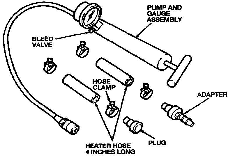

3. Install a short piece of heater water hose approximately 10 cm (4 inches) in length on each heater core tube.
4. Prepare the heater core as follows:
a. Fill the heater core and heater water hoses with water.
b. Install plug in one heater water hose end and Adapter from Rotunda Radiator/Heater Core Pressure Tester 014-R1072 or equivalent in the other heater water hose end.
c. Secure the hoses, plug and adapter with hose clamps.
5. Pressure test the heater core as follows:
a. Attach the Rotunda Radiator/Heater Core Pressure Tester 014-R1072 or equivalent to the adapter on the heater water hose.
b. Close the bleed valve at the base of the gauge.
c. Pump 103 kPa (15 psi) of air pressure into the heater core.
6. Observe the pressure gauge for a minimum of three minutes. The pressure should not drop.

2. Attach the heater water hoses with the plug and adapter to the heater core tubes as indicated in the in-vehicle pressure test.
3. Attach the Rotunda Radiator/Heater Core Pressure Tester 014-R1072 or equivalent to the adapter.
4. Pump 103 kPa (15 psi) of air pressure into the heater core.
