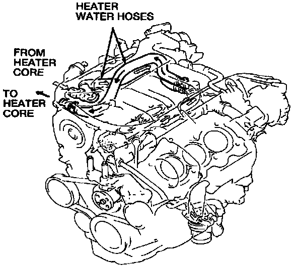

Heater Hose: Service and Repair
REMOVAL
1. Drain the cooling system.
2. Remove the Engine Air Cleaner (ACL).
3. Release the clamp and remove the heater water hoses from the heater core tubes.
4. Release the clamps and remove the heater water hoses from the engine block.
5. Remove the heater water hoses from the vehicle.
INSTALLATION
2. Fill the cooling system.
