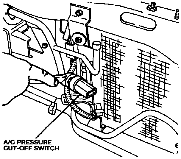

1. Disconnect the A/C pressure cutoff switch electrical connector.
NOTE: The A/C pressure cut-off switch is located on the condenser to evaporator tube in front of the A/C condenser core.
2. Remove the A/C pressure cut-off switch.
