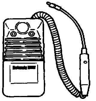

LEAK DETECTOR, ELECTRONIC
1. Attach R-134a Manifold Gauge Set 176-R032A or equivalent to the service gauge port valves as indicated in the instruction manual provided in the A/C service kit.
2. Leave both manifold gauge set valves closed. Both gauges should indicate approximately 413-551 kPa (60-80 psi) at 24°C (75°F) with the engine off.
3. If very little or no pressure is indicated, charge the refrigerant system. Refer to the Charging System procedures. Evacuation and Charging
4. Leak test the refrigerant system using Rotunda R-134a Automatic Calibration Halogen Leak Detector 023-R1000 or equivalent.
The electronic leak detector will automatically calibrate itself when switched to the ON position. Move the leak detector probe slowly, approximately 25 mm (1 inch) per second, past the suspected area. When escaping refrigerant gas is detected, a ticking or beeping signal will be heard. As the amount of refrigerant gas detected increases, the rate of the ticking or beeping increases. If the refrigerant gas is relatively concentrated, the signal will become increasingly shrill. Follow the instructions included with the leak detector for proper handling and operating techniques.
