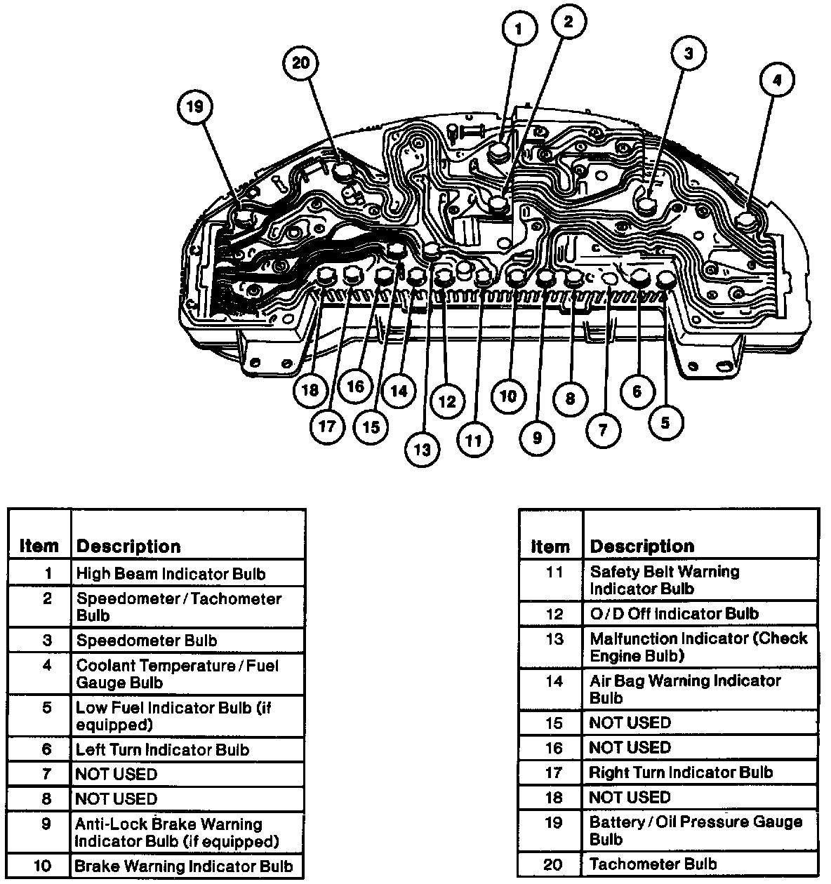

Instrument Panel Bulb: Service and Repair
REMOVAL
1. Remove the instrument cluster from the vehicle.
2. Remove the desired miniature bulb by turning it counterclockwise one-quarter turn and lifting it straight out of the instrument cluster back plate.
INSTALLATION
