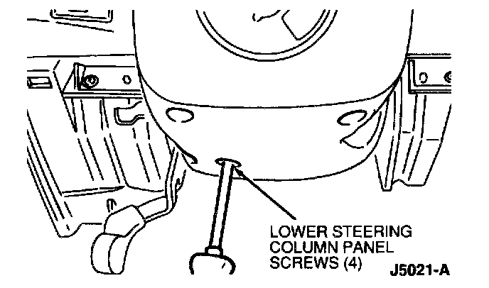

2. Remove the four lower steering column shroud screws.
3. Separate the upper and lower steering column shrouds.

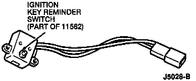

11. Disconnect the ignition key reminder switch electrical connector.
12. Remove the ignition key reminder switch.
