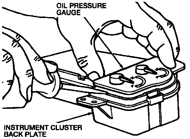

REMOVAL
1.
Remove the instrument cluster printed circuit.
2.
Remove the
oil pressure gauge
from the instrument cluster back plate.
INSTALLATION
