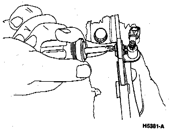

2. Remove the two parking brake lever boot screws.
3. Remove the parking brake lever boot.
4. Remove the screw from the parking brake signal switch and bracket located on the parking brake control.
5. Disconnect the parking brake signal switch and bracket electrical connector from the parking brake control.
6. Remove the parking brake signal switch and bracket.
