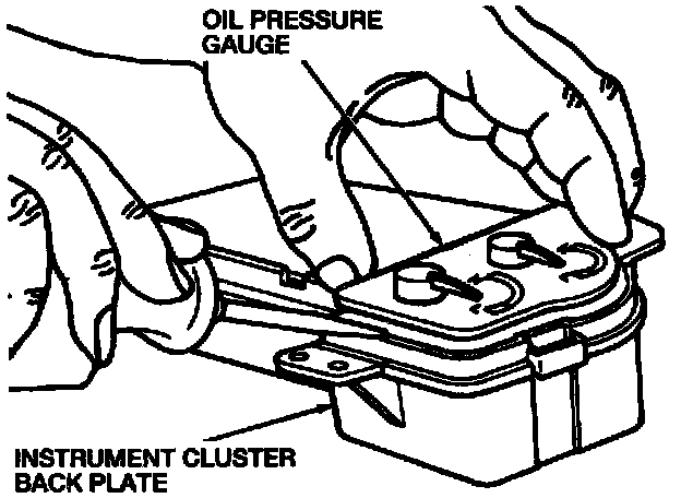

2. Remove the oil pressure gauge from the instrument cluster back plate.

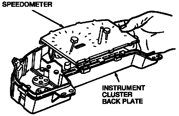

4. Remove the speedometer from the instrument cluster back plate.

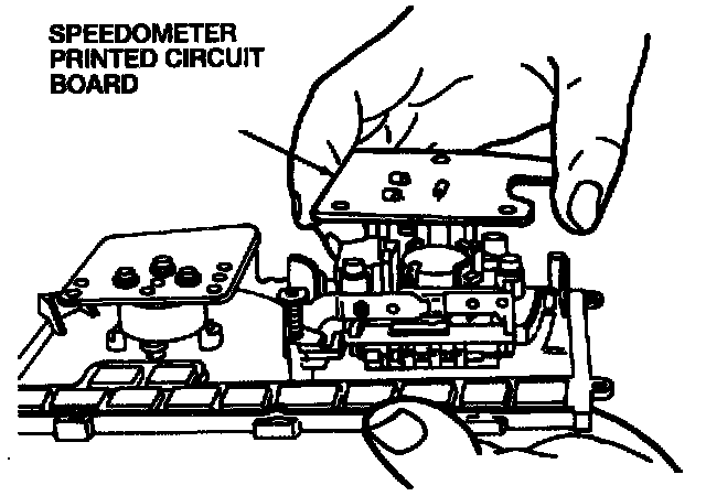

5. Press in the two tabs and remove the speedometer printed circuit board.
