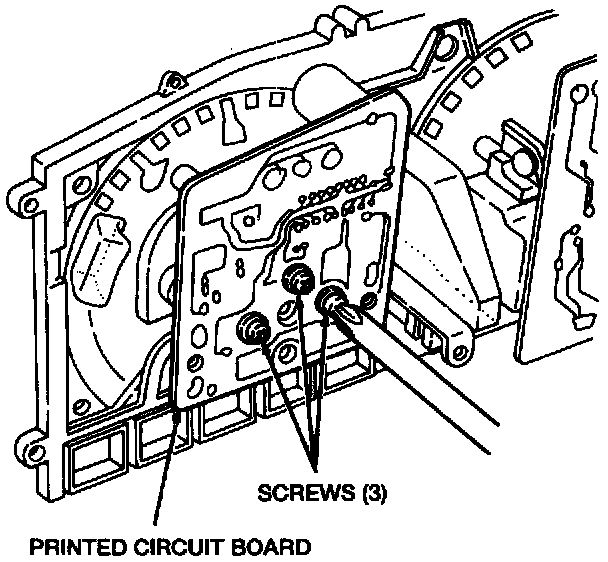

3. Remove the fuel gauge from the instrument cluster back plate.
4. Remove the speedometer from the instrument cluster back plate.
5. Remove the three tachometer printed circuit board screws.
6. Remove the tachometer printed circuit board from the tachometer.
