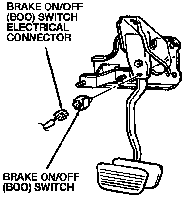

Brake Light Switch: Description and Operation
The stoplamp system is controlled by the Brake On/Off
(BOO)
switch, which is operated by the brake pedal arm. When the brake pedal is pressed, the BOO switch activates the stoplamps.
