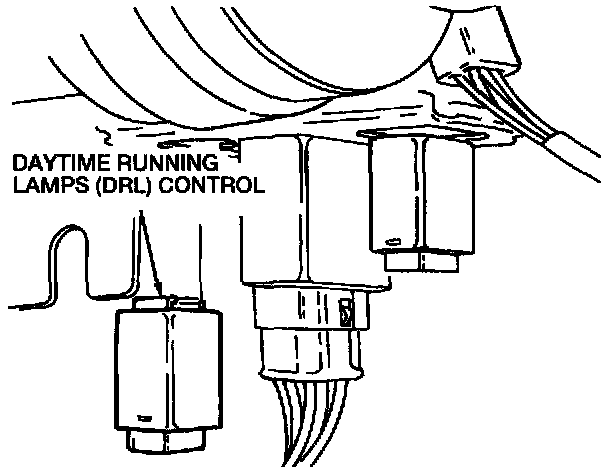

The daytime running lamps control is located underneath the instrument cluster, near the cowl side trim panel.
1. Disconnect the Daytime Running Lamp (DRL) control electrical connector.
2. Remove the daytime running lamps control by sliding it out of the metal bracket.
CAUTION: Pulling the daytime running lamps control straight down from the metal bracket may break the plastic tabs on the daytime running lamps control.
