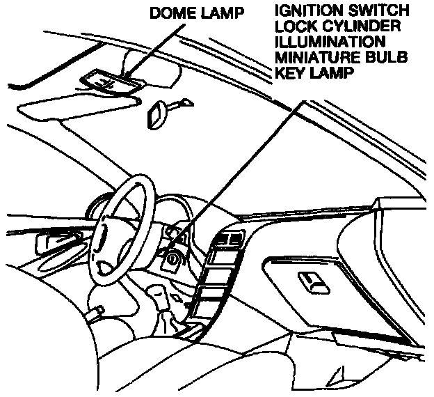

Illuminated Entry
The illuminated entry system includes:
- Central Processing Unit (CPU).
- Two courtesy lamp switches.
- Ignition switch lock cylinder illumination miniature bulb key lamp.
The illuminated entry system can be activated by the courtesy lamp switches.
When the illuminated entry system is activated, the ignition switch lock cylinder illumination miniature bulb will automatically light and stay lit for approximately 10 to 30 seconds.
When either front door is opened, the dome lamp is activated. With illuminated entry, the dome lamp will turn off shortly after the front door is closed. Without illuminated entry, the dome lamp will shut off when the front door is closed.
The CPU is a microprocessor connected directly to the interior fuse junction panel.
