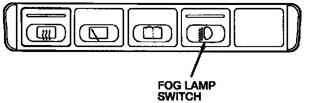

Fog/Driving Lamp Switch: Description and Operation
To operate the fog lamps, the low beams must be on. The fog lamp switch is located on the instrument panel finish panel.
