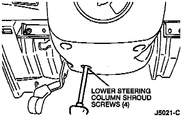

2. Remove the four lower steering column shroud screws.
3. Separate the upper and lower steering column shrouds.

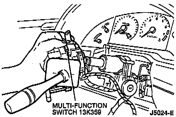

6. Remove the three multi-function switch screws.
7. Disconnect the multi-function switch electrical connectors.
8. Slide the multi-function switch off of the steering column.
