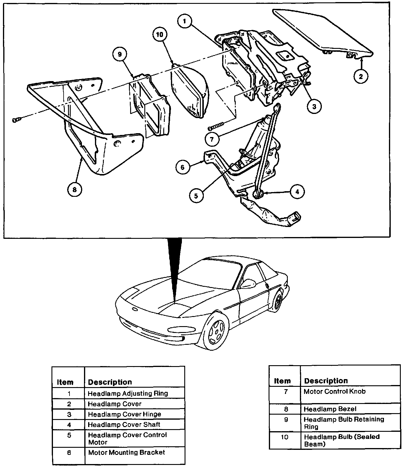

The headlamp assembly consists of:
- Headlamp cover hinge.
- Headlamp adjusting ring.
- Sealed beam halogen type headlamp bulb.
- Headlamp bulb retaining ring.
- Headlamp bezel.
- Headlamp cover.
- Headlamp cover control motor.
The headlamp bulb is installed through the front of the headlamp adjusting ring and is held in position by a headlamp bulb retaining ring. The headlamp assembly is mounted to the chassis by the headlamp cover hinge.
The headlamp cover control motor is located under the headlamp cover hinge. The headlamp cover control motor pushes up and pulls down the headlamp cover shaft which attaches the headlamp housing to the headlamp cover control motor. Consequently, the headlamp is pulled to the retracted position without changing headlamp aim.
NOTE: The manual control knob should only be used after the headlamp cover control motor fuse, located in the main fuse junction panel, has been removed or the battery ground cable has been disconnected.
A manual control knob is located on top of the headlamp cover control motor and can be reached from the engine compartment.
