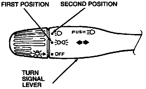

Headlamp Switch: Description and Operation
The headlamp switch controls the headlamps, the front parking lamps and the rear lamps. When the headlamp switch is rotated to the first position, these lamps are illuminated:
- Rear lamps.
- Front parking lamps.
- Rear license plate lamps.
- Instrument panel lamps.
- Cigar lighter illumination ring.
When the headlamp switch is rotated to the second position, the headlamp bulbs are activated and the headlamp cover control motors lift the headlamps to the on position.
