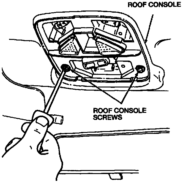

REMOVAL1. Disconnect the battery ground cable.
2. Carefully remove the dome interior lamp lens from the roof console.
3. Remove the two root console screws and lower the roof console.
4. Disconnect the two electrical connectors and remove the roof console.
