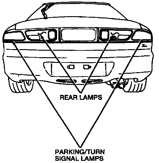

Tail Lamp: Description and Operation
The front and rear parking, license plate, and rear lamp systems are controlled by the headlamp switch. When the headlamp switch is rotated to the first position, these lamps are illuminated:
- Rear lamps.
- Front parking lamps.
- Rear license plate lamps.
- Instrument panel lamps.
- Cigar lighter illumination ring.
