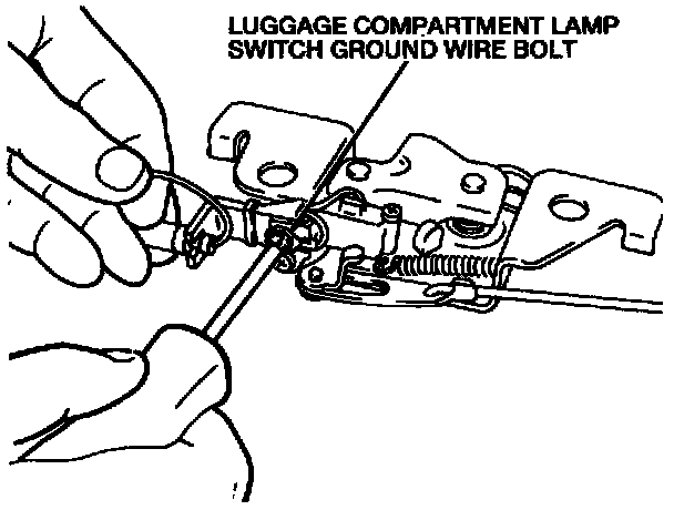

REMOVAL
1. Remove the tailgate latch.
2. Remove the luggage compartment lamp switch ground wire bolt.
3. Remove the luggage compartment lamp switch bolt.
4. Remove the luggage compartment lamp switch from the liftgate latch.
