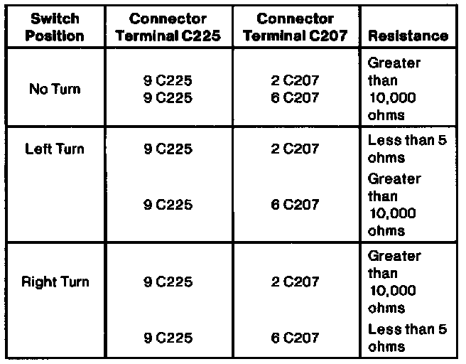

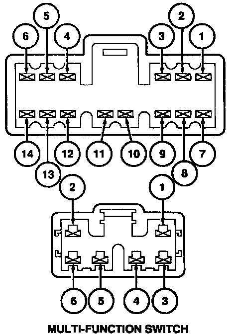

1. Key OFF.2. Disconnect the multi-function switch connectors C225 and C207.
3. Measure the resistance of the terminals on the multi-function switch as indicated in the illustration.
4. If the turn signal switch is OK, return to the pinpoint tests. Pinpoint Tests
