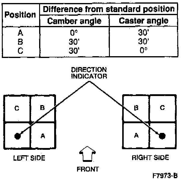

NOTE: The front shock absorber upper mounting bracket studs on the front spring and shock are offset. Camber is adjusted by rotating the front shock absorber upper mounting bracket to one of the following 3 positions:
Check camber against specifications. If necessary set the camber as follows:

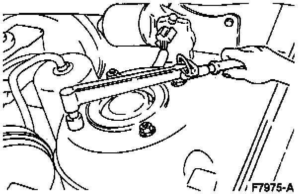

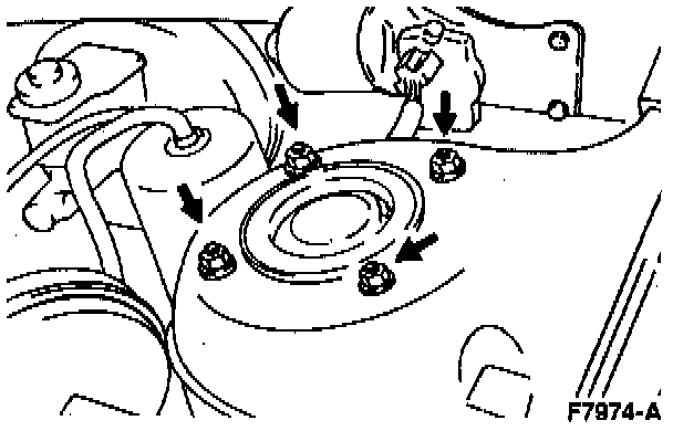

3. Loosen and remove the front shock absorber upper mounting bracket nuts.
4. Lower the front spring and shock and rotate the front shock absorber upper mounting bracket to the desired position.
5. Reinstall the front spring and shock.
6. Install and tighten the front shock absorber upper mounting bracket nuts.
