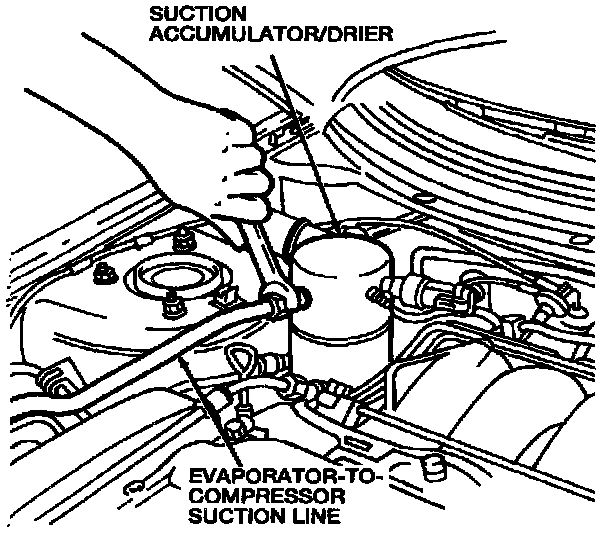

2. Remove the ABS wiring harness from the evaporator to compressor suction line.
3. Disconnect the evaporator to compressor suction line at the suction accumulator/drier. Discard the O-ring.
4. Remove the evaporator to compressor suction line hold-down clamp nut. Disconnect the hold-down clamp.
5. Remove the evaporator to compressor suction line manifold bolt. Discard the O-ring.
6. Remove the evaporator to compressor suction line.
