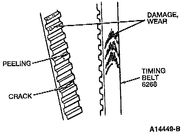

Inspect and replace the
timing belt
if it is contaminated with oil or grease. Also, inspect the timing belt for damage, wear, peeling, cracks, or hardening. If necessary, replace the timing belt.
