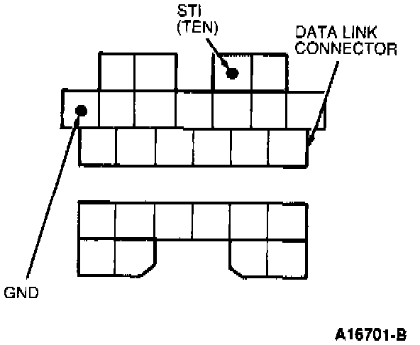

Data Link Connector:
4. Connect a jumper wire between terminals STI (TEN) and GND of the Data Link Connector (DLC) located in the left hand front corner of the engine compartment, near the battery.

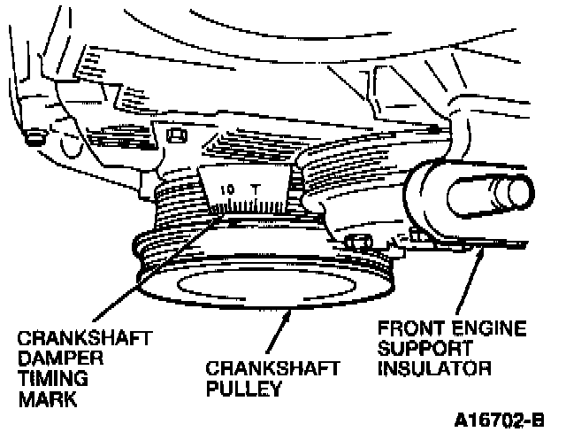

7. Verify the ignition timing is 9-11° (10° +/- 1°) BTDC.
Timing Marks:
8. If the ignition timing is not within specifications, loosen the distributor bolts and adjust the ignition timing. Tighten the distributor bolts to 19-25 Nm (14-18 lb ft).

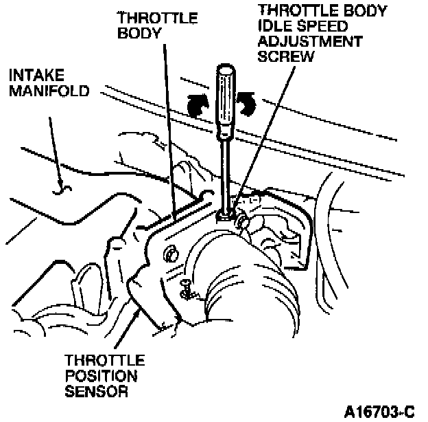

Idle Speed Adjustment Screw:
12. Adjust the idle speed by turning the throttle body idle speed adjustment screw until the idle speed of 650 rpm +/- 50 rpm is attained.

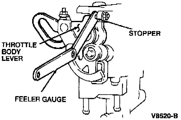

Inserting Feeler Gauge:
16. Insert a 0.15 mm (0.006 inch) feeler gauge between the stopper and the throttle body lever.

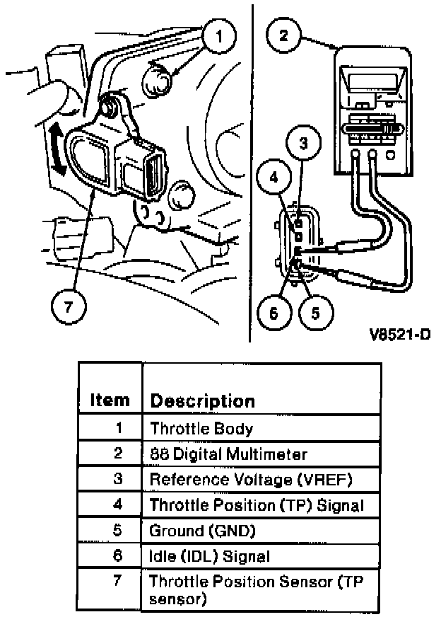

Throttle Position Sensor:
17. Continuity SHOULD exist between terminals as shown.
18. Insert a 0.50 mm (0.020 inch) feeler gauge between the stopper and the throttle body lever.
19. Continuity should NOT exist between terminals as shown.
20. If not within specifications, adjust the throttle position sensor. Tighten the throttle position sensor screws to 2 Nm (14-20 lb in).
