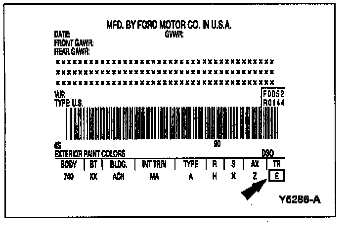

Transmission Identification
The code within the "TR" space denotes the type of transmission installed.
MANUAL TRANSMISSION
D -- 5 speed overdrive
R -- 5 speed overdrive (MTX-75)
W -- 5 speed overdrive (G5M)
445- 5 speed overdrive (Probe)
AUTOMATIC TRANSMISSION
N -- 3 speed
L -- 4 speed overdrive (AX4S)
X -- 4 speed overdrive (AX4N)
Y -- 4 speed overdrive (CD4E) [1]
44T- 4 speed overdrive (4EAT) [2]
E -- 4 speed overdrive (IF4E)
[1] 2.0l Probe
[2] 2.5l Probe
