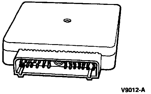

Powertrain Control Module:
LOCATION
The PCM is mounted forward of the center console between the console front finish panels.
