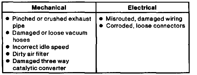

2. Visually inspect the components of the catalyst and exhaust system.
3. Exercise the wiring and connectors for the solenoids and other components for obvious problems due to looseness, corrosion, or other damage.
4. Check the vacuum lines and connections for looseness, pinching, leakage, splitting, blockage, or other damage that may cause malfunction.
5. If a vacuum line or orifice (restrictor) blockage is suspected as the obvious cause of malfunction, correct the cause before proceeding to the next step.
6. Check engine oil for fuel dilution.
7. If all checks are OK, proceed to Exhaust Leakage or Noise check.
