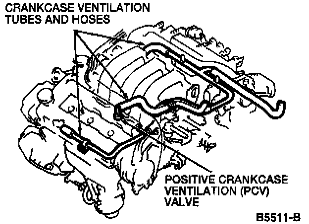

Crankcase Ventilation System:
1. Pull the crankcase ventilation hose off the Positive Crankcase Ventilation (PCV) valve.
2. Pull the PCV valve from the crankcase ventilation grommet in the front valve cover.
3. To install, reverse the removal procedure.
