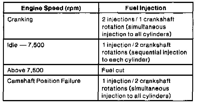

Injection Timing:
When the engine is cranking, fuel is supplied to all the cylinders simultaneously, one injection for each fuel injector per crankshaft revolution. Between engine idle speed and 7,500 rpm, during PCM or Camshaft Position Sensor (CMP) failure, fuel is supplied through the fuel injectors once every two crankshaft revolutions (one injection per cycle).
To prevent overspeeding and possible engine damage, the fuel supply is cut if engine speed exceeds 7,500 rpm. If engine speed momentarily exceeds 7,500 rpm, the fuel supply is interrupted until the engine speed drops below 7,500 rpm. The fuel supply will also be interrupted if the engine speed exceeds 5,500 rpm and the coolant temperature is below -15°C (5°F).
To improve fuel economy during high-speed deceleration, the fuel supply is interrupted, based on input from various sensors and switches, until the specified engine speed is reached.
To facilitate starting the engine if the spark plugs become fouled (engine flooded), fuel injection is cut if the throttle valve is held wide-open while cranking. This allows the spark plugs to dry and purges excess fuel from the cylinders.
