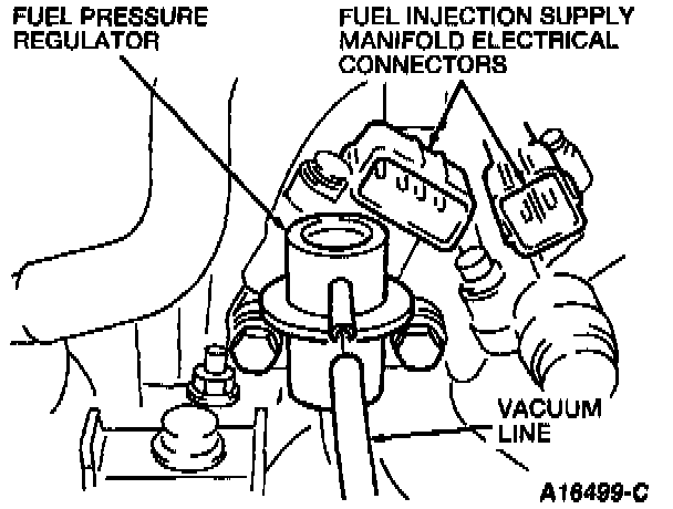

Fuel Pressure Regulator:
6. Disconnect the fuel return hose and vacuum line from the fuel pressure regulator.
CAUTION: Plug the fuel lines once removed from the fuel injection supply manifold to prevent fuel leakage.

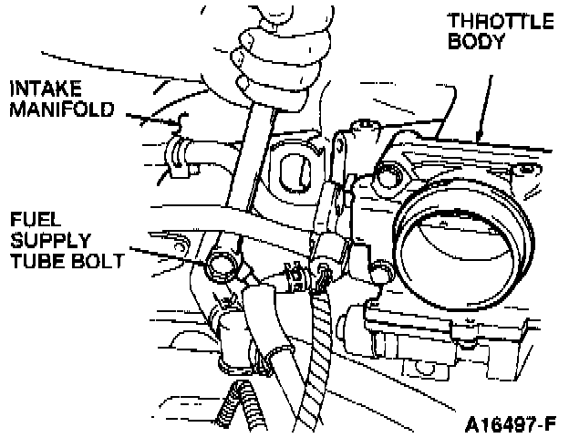

Supply Tube Bolt:
7. Remove the fuel supply tube bolt from the fuel injection supply manifold. Discard the copper crush washers.

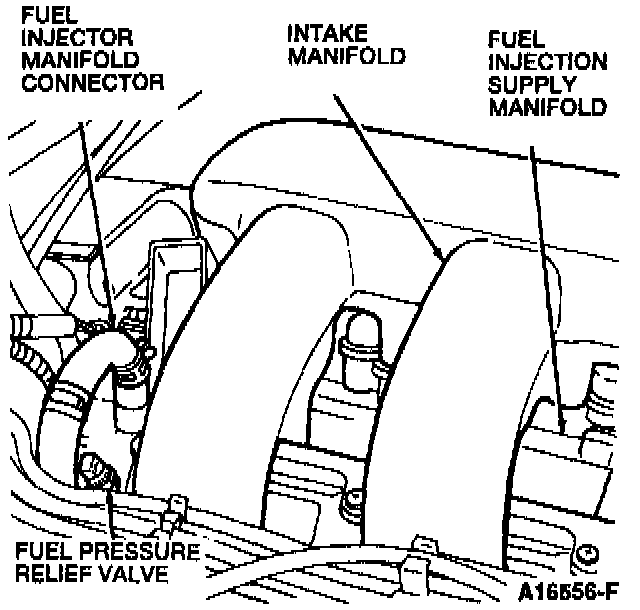

Intake Manifold:
8. Remove the fuel injector manifold connector from the rear side of the fuel injection supply manifold.

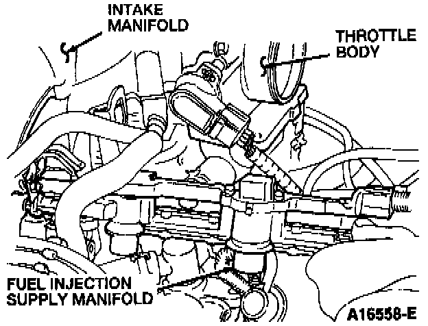

9. Remove the two rear fuel injection supply manifold bolts.
Supply Manifold:
10. Lift slightly, then slide the rear fuel injection supply manifold toward the LH side of the vehicle to remove.
11. Remove the isolators from their seats.
12. Remove the two front fuel injection supply manifold bolts.
13. Lift slightly, then slide the front fuel injection supply manifold toward the LH side of the vehicle to remove.
14. Remove the isolators from their seats.
