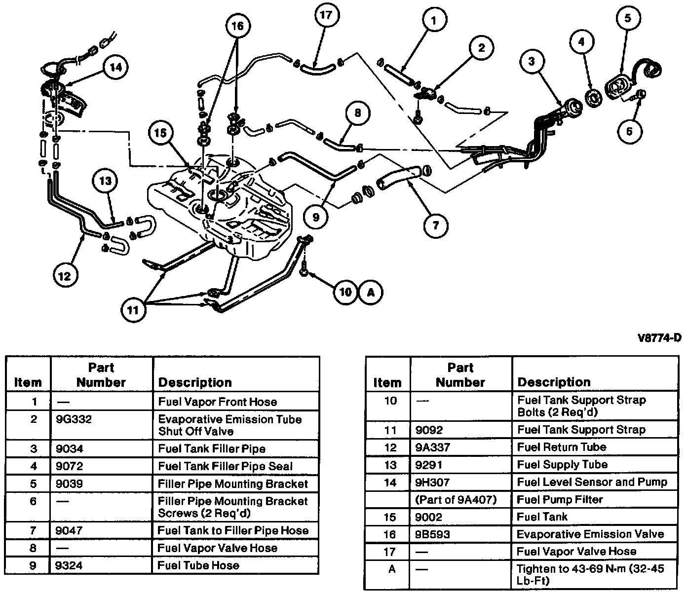

Rollover Valve: Service and Repair
REMOVAL and INSTALLATION
1. Remove the fuel tank.
2. Loosen the clamp and disconnect the vacuum hose.
3. Remove the evaporative emission valve from the grommet in the top of the fuel tank.
4. To install, reverse the removal procedure.
