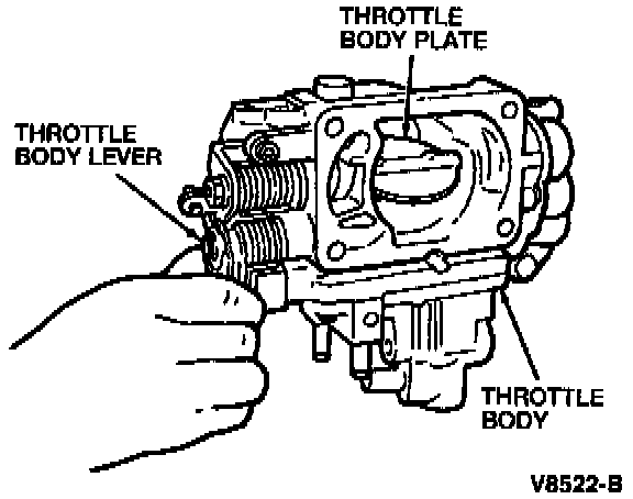

Throttle Body: Testing and Inspection
Throttle Body:
CAUTION: The throttle body for this vehicle is a sludge tolerant design and should not be cleaned.
1. Check the throttle body for wear and deposits.
2. Verify that the throttle valve moves smoothly from the fully closed to the fully open position and back.
3. Replace the throttle body if necessary.
