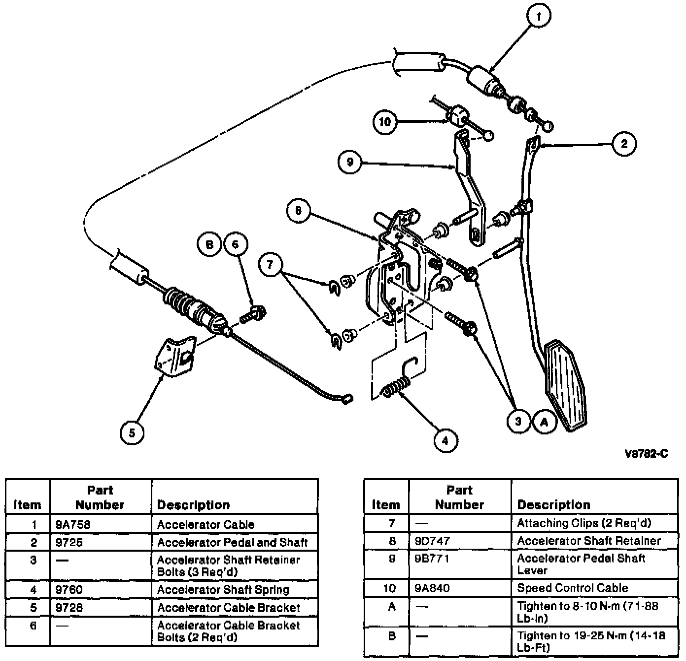

Throttle Cable/Linkage: Description and Operation
Accelerator Pedal And Linkage:
DESCRIPTION
The throttle is controlled by an accelerator cable attached to the accelerator pedal and shaft. The throttle assembly is adjustable for free play and wide-open throttle position. On vehicles equipped with speed control, the speed control cable is also attached to the accelerator pedal and shaft.
