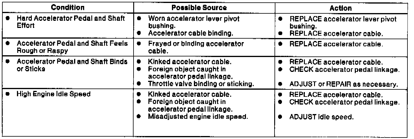

- Inspect the engine idle speed adjustment to be sure of correct idle speed specification after any accelerator linkage adjustment or repair.
If a visual inspection fails to identify or correct the problem, refer to the Symptom Chart.
