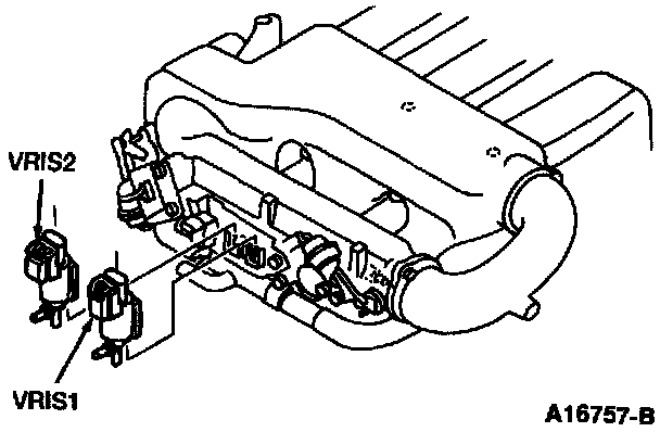

There are two vacuum chambers located under the front (LH) bank of the intake manifold. These vacuum chambers maintain a constant vacuum to the VRIS shutter valves during wide open throttle operation and other low-vacuum, low-speed situations.
Solenoids:
OPERATION
The Powertrain Control Module (PCM) applies voltage to the VRIS solenoids 1 and 2, and the solenoids apply vacuum to the shutter valve actuators which move the shutter valves.
