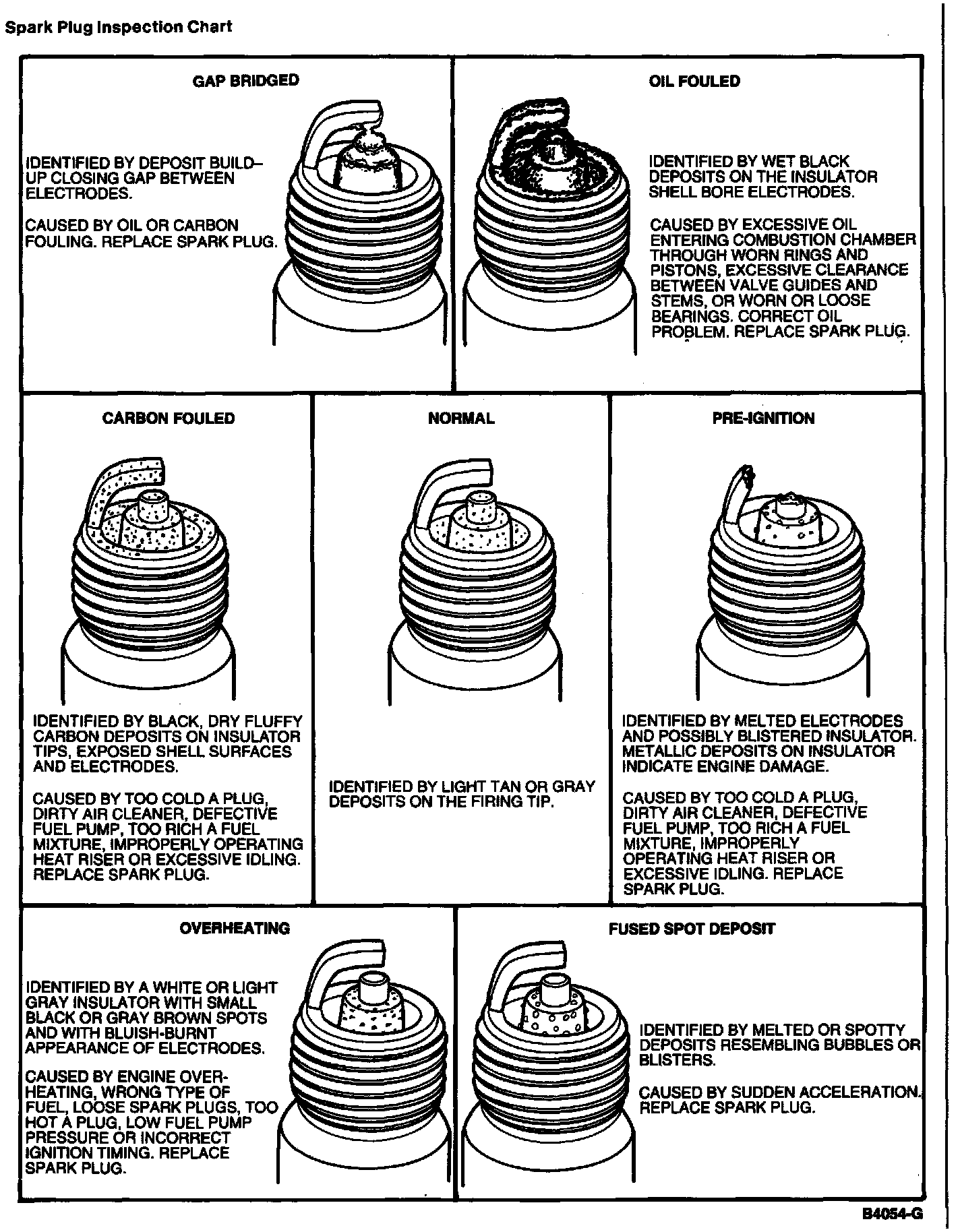

Clean spark plugs as necessary using a wire brush or professional spark plug cleaner (follow manufacturer's instructions). Inspect the firing tip. Refer to Spark Plug Inspection Chart. Replace spark plugs if they are worn or damaged.
