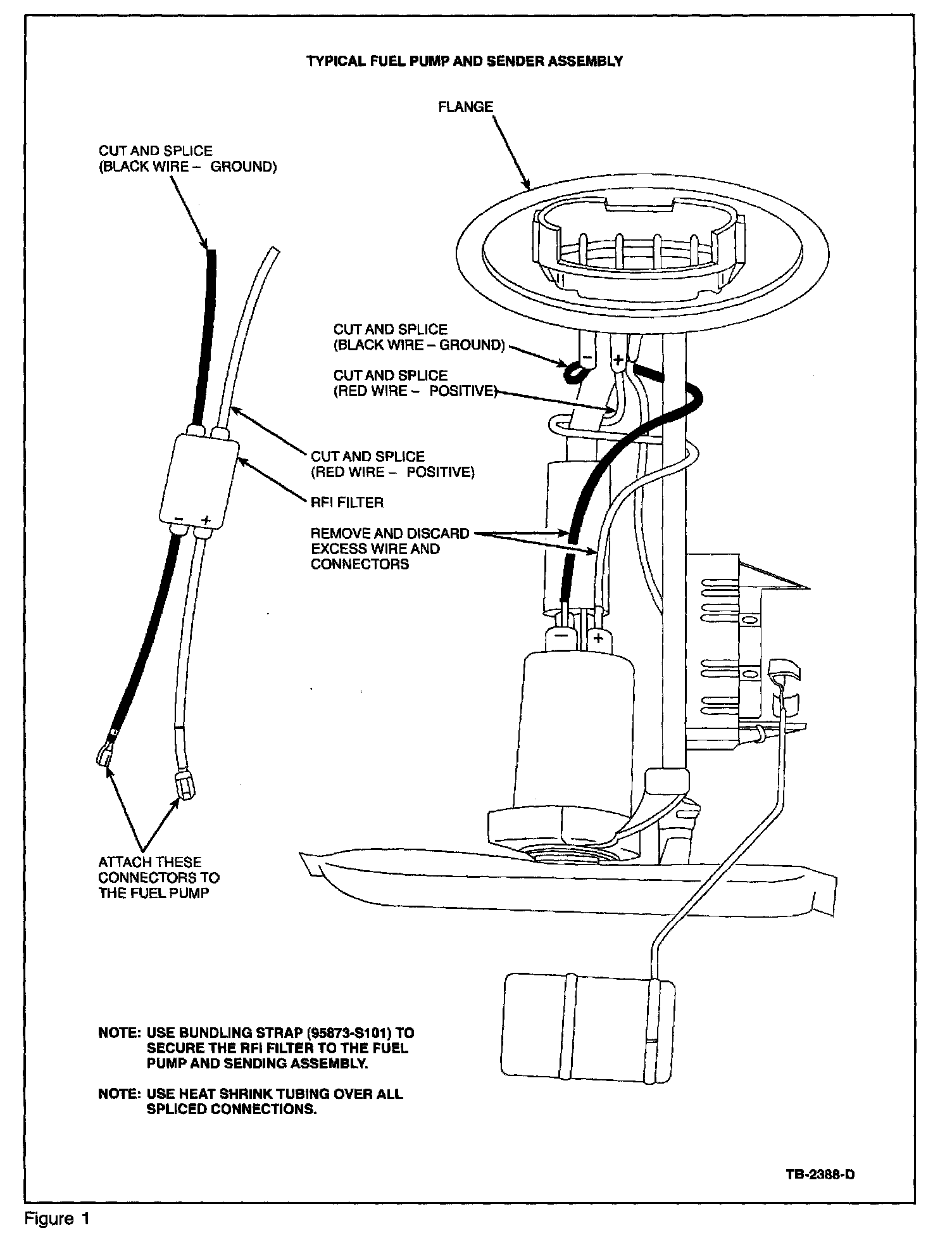

2. On vehicles without a fuel delivery module, remove the negative and positive connectors from the fuel pump, Figure 1.
a. Cut the wires to the fuel pump 76 mm (3") from the flange of the fuel pump and discard the wires.
b. Connect the RFI filter connectors to the spade terminal on the fuel pump.
c. Cut and solder both the red and black wires of the RFI filter to the red and black wires of the flange. Use Heat Shrink Tubing (F5AZ-14A099-AA) over the solder connections.

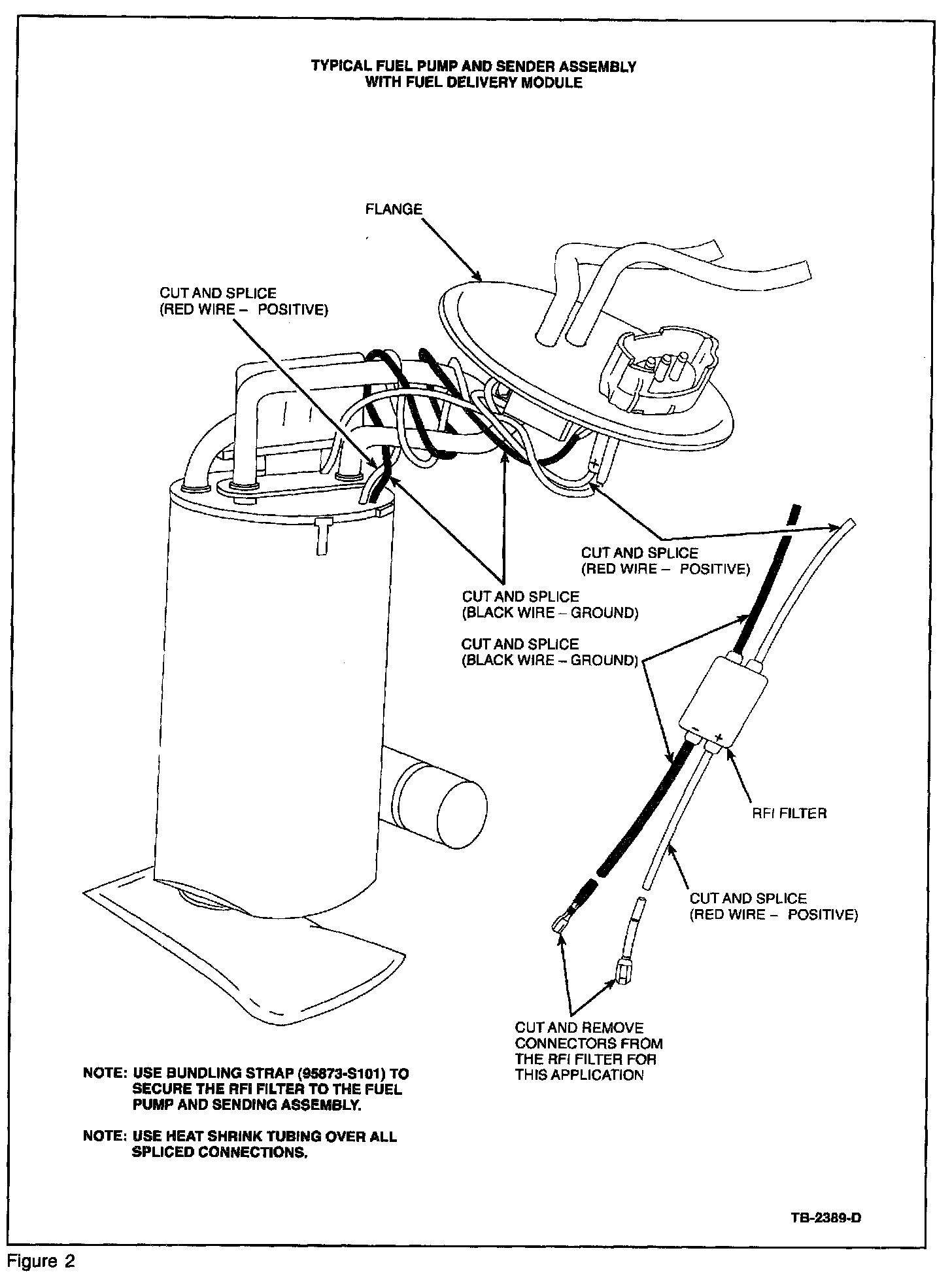

3. On light trucks and compact trucks with a fuel delivery module, cut the fuel pump wires to the fuel delivery module 50 mm (2") from the flange and discard the wires, Figure 2.
a. Cut the connectors from the RFI filter and solder wires to the fuel delivery module (red to red and black to black). Use heat shrink tubing over solder connections.
b. Solder wires from the RFI filter to the flange wires (red to red and black to black). Use heat shrink tubing over soldered connections.

4. Secure the RFI filter to the fuel pump and sender assembly with a Bundling Strap (95873-S101) to prevent rattling in the tank, Figures 1 and 2.
