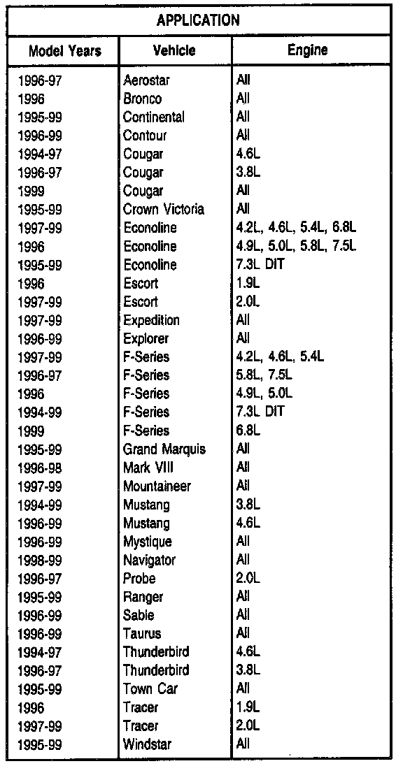

This TSB article is being republished in its entirety to update the affected vehicles and to include an Application Chart for the affected vehicles.

Refer to the Application Chart in this article to use the new 15- to 104-Pin Flash Cable to handle all necessary out-of-vehicle programming of EEC V modules in the vehicles listed. This may allow added flexibility in servicing aftermarket and fleet accounts as well as provide the ability to have modules updated to new calibrations through the Parts Department instead of ordering new parts.
